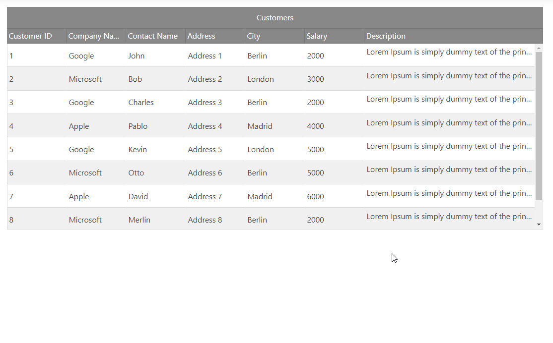

        The described scenario could be observed here:
        In addition, I have prepared a small sample illustrating this behavior which could be found attached here. Please test it on your side and let me know how it behaves.
        More information can be found in the Tooltips Feature topic from our Ignite UI jQuery documentation.
        If you require any further assistance on the matter, please let me know.
