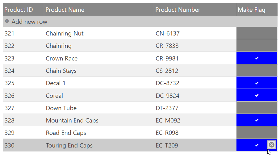

I'd like some advice, I use the iggrid with the renderCheckboxes which is fine when all the cells in the column are editable or not (we use a different css class to indicate that the column is editable or not) . But for one of my grid I need to do that on a cell level for example in the same column:
– Editable cells: checkboxes are blue
– Readonly cells : checkboxes are grey.
I tried to use a template in that column, cloning the html of the standard ui-checkbox and adding some CSS class to indicate the read-only aspect of the cell. But I need to use the value of the cell itself to get the check state and that doesn't seem to work:
