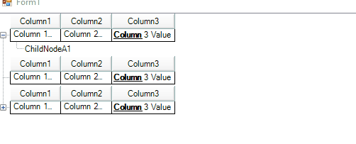

        What I can suggest in order to avoid displaying the combo drop down button at all times would be to set its DropDownButtonDisplayStyle property to “OnMouseEnter”. In this way, the node’s cells will appear as normal textboxes, nevertheless the user will still have an indication on hovering that the values could be edited by choosing from a combo. Here is the result:
        I am suggesting this as I am not sure if there would be a straightforward approach to set a textbox for display and a combo for edit mode separately. Additonally, in case my understanding of your requirement is incorrect, please, do elaborate further.
        Regarding your second question, you could use an UltraFormattedTextEditor or an UltraFormattedLinkLabel control to display formatted text. The sample also demonstrates this.
                        node.Cells["Column3"].Value = "Column 3 Value";
         UltraFormattedTextEditor ufll = new UltraFormattedTextEditor();
                    this.ultraTree1.ColumnSettings.ColumnSets[0].Columns["Column3"].EditorComponent = ufll;
